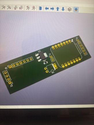

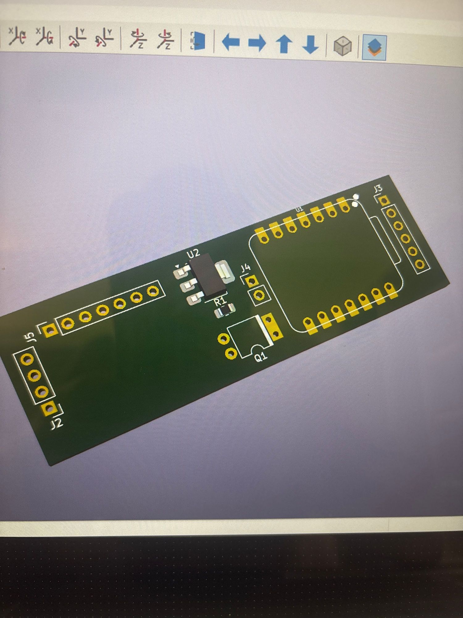

BME280 will be on same side as Seeeduino and OLED on opposite side. Diode of original design replaced with SMD voltage regulator so you can use any voltage up to 18 volts. 6 pin header used for clean wiring
